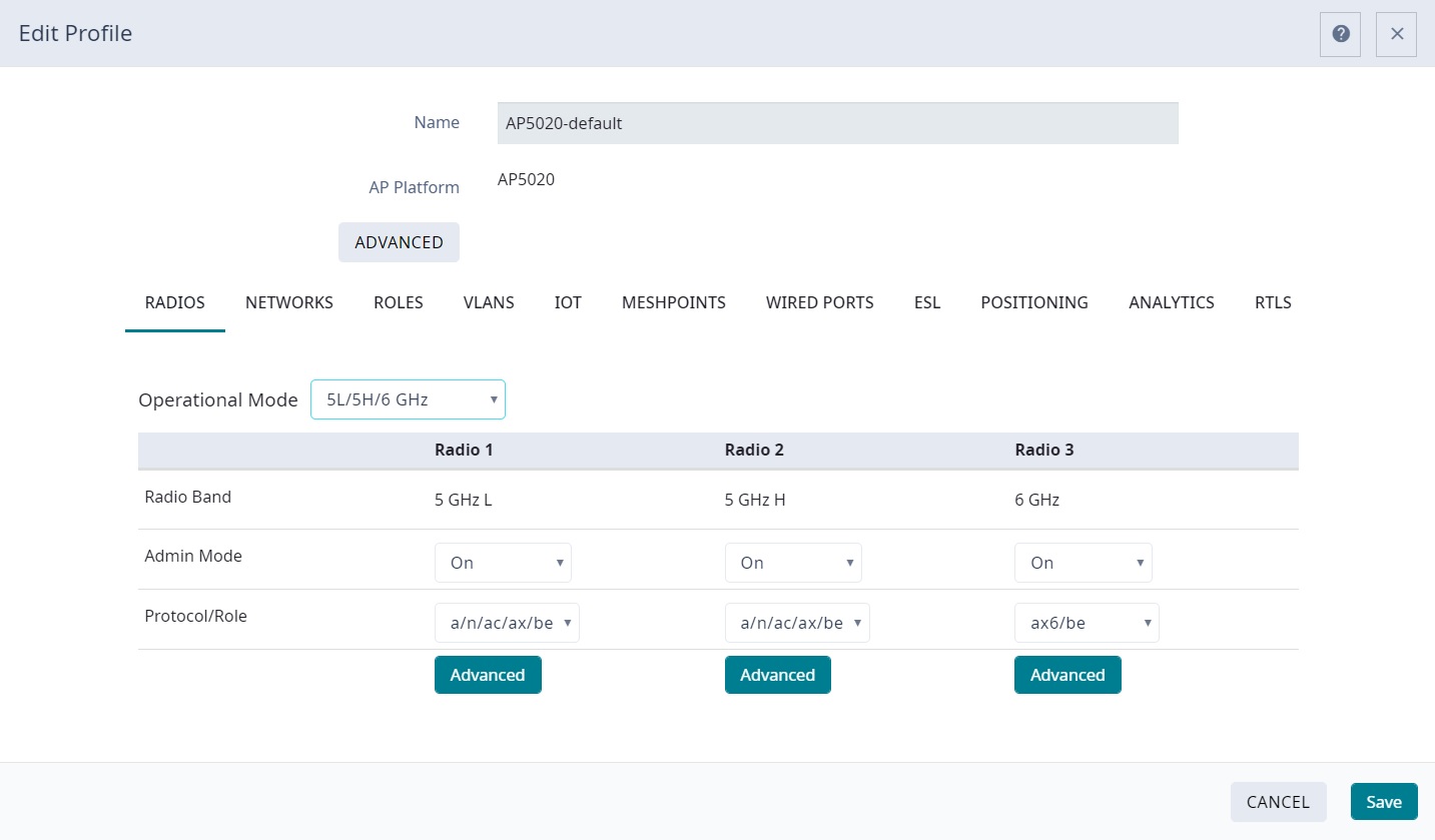

Configure radio Mode from the device group configuration Profile Radios tab.
  1. Go to Sites and select a site.
  2. Select Device Groups and select a device group.
  3. Next to the Profile field, select to edit the profile.
  4. Select the Radios tab.
Configuration Profile showing the Radio Mode on the Radios tab.
ExtremeCloud IQ Controller presents valid values for Radio Mode based on the AP capability.

Note: For AP5020, indicate the Operating Mode. Based on selected operating mode, the Radios field is updated. Radio mode selection depends on Operating Mode. For example, when operating mode is 2.4/5/6 GHz Service, the Radio configuration on the profile allows 2.4 GHz modes for Radio 1, 5 GHz modes for Radio 2, and 6 GHz modes for Radio 3.
